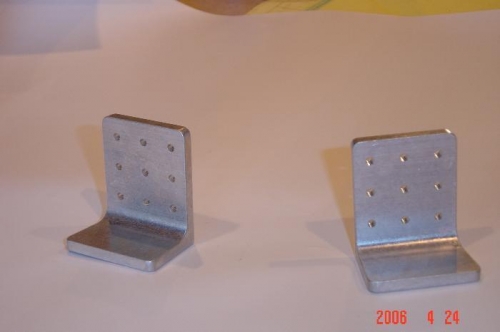

Date:  4-17-2006
Number of Hours:  1.50
Manual Reference:  DRW-3
Brief Description:  HS-908L and HS-908R Attach angles
Since I work in a machine shop I elected to take the angle to work and make the parts there. I saw cut the supplied angle to rough length and machined the parts to print on a Bridgeport mill. I'm sure this saved some time compared to other methods of manufacturing.Afterward I tumbled the parts in ceramic media for a smooth deburr. Total time 1.5 hours.
HS-908 R and L
HS-908 R and L
