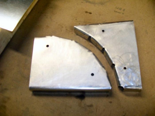

Brief Description:  Started making some form blocks
Made some form blocks today, specifically the ones for the aileron nose ribs and the aileron pocket ribs. I have decided to use 3/4" MDF for all form blocks due to availability, durability and ease of machining. I also made cutting template blocks as I am going to be using the router method of cutting the blanks to size. It is a bit of extra work to make the extra blocks. It is also VERY messy. Aluminum chips go EVERYWHERE if you do not try to contain them. This method is woth it, though for the speed of making the blanks and the repeatability of blank sizes.
I also formed a few "test" ribs from the blocks to see how well they worked. I was not dis-pleased :)
