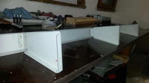

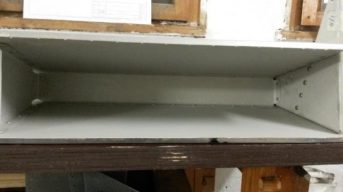

Brief Description:  Flaps TE L/R int. structure corrosion prevention
1.Preparation of internal surfaces of L/R TE Flapps assemblies for application of chemical conversion coating and epoxy primer performed
2.Application of chemical conversion coating (wash primer) on L/R TE Flapps assemblies
internal structure for corrosion prevention purpose perfomerd.
3.Application of epoxy primer on L/R TE Flapps assemblies internal structure for corrosion prevention purpose perfomerd.
