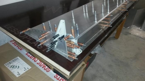

Brief Description:  Flap TE R/H pre-assembly
1.Allocating all components and inspection for damages performed
according PARTS LIST 357M8 Flap T/E

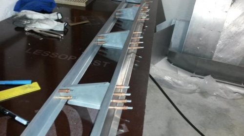

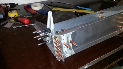

2.Folowing the DWG 357M8 and instruction for assembly of the R/H wing T/E Flap,
internal and external structural components joined and drilled through the pilot holes
for initial pre- assembly of the Flap.
3. Final geometry check of R/H wing T/E Flap assembly performed.
4. All holes in the structural parts drilled to final diameter and deburred as per the drawing 357M8
