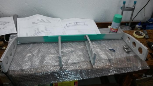

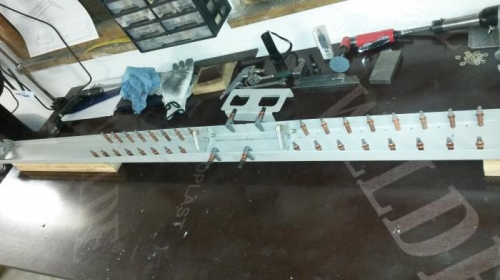

1. Jig assembly UJ-320 set up for Horizontal Stabilizer Pre-assembly performed.
2. Folowing the DWG 355M and instruction for assembly of the Horizontal Stabilizer,
internal structural components joined and drilled through the pilot holes
for initial pre- assembly of the Horizontal Stabilizer.
3. All holes in the structural parts drilled to final diameter and deburred as per the drawing 355M
