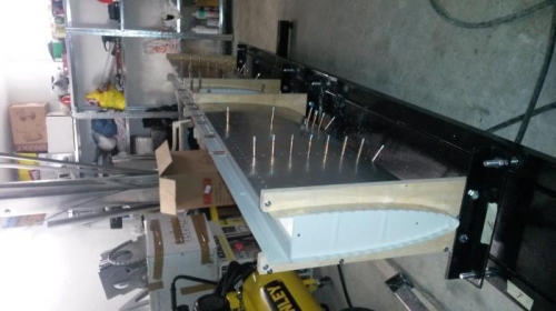

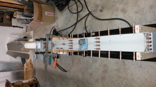

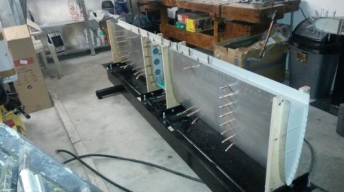

Brief Description:  Horizontal Stabilizer Pre-assembly
1. Horizontal Stabilizer external skin fited into the JIG "UJ-320"
2.Folowing the DWG 355M and instruction for assembly of the Horizontal Stabilizer,
internal structural components joined with external skin and drilled through the pilot holes
for initial pre- assembly of the Horizontal Stabilizer.
3. Final geometry check perfomed and all holes driled to final diameter and debured
