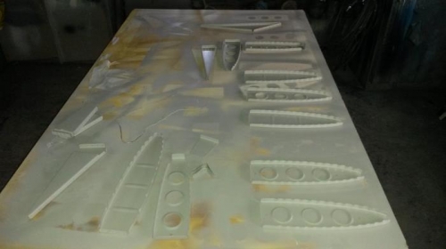

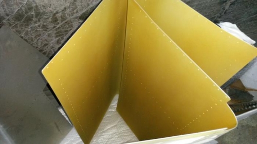

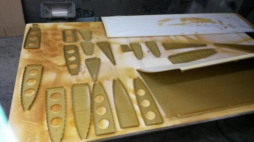

Brief Description:  Elevator L/H int. structure corrosion prevention
1.Preparation of internal surfaces of L/H Elevator assembly for application of chemical
conversion coating and epoxy primer performed
2.Application of chemical conversion coating (wash primer) on L/H Elevator assembly
internal structure for corrosion prevention purpose performed.
3.Application of epoxy primer on L/H Elevator assembly internal structure for corrosion
