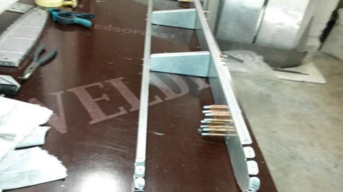

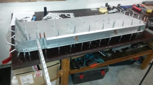

Brief Description:  Elevator Assy. R/H pre-assembly
1.Allocating all components and inspection for damages performed
according PARTS LIST 355M4 Elevator Assy. R/H
2.Folowing the DWG 355M4 and instruction for assembly of the Elevator Assy. R/H
internal and external structural components joined and drilled through the pilot holes
for initial pre- assembly of the Aileron.
3. Final geometry check of R/H Elevator assembly performed.
4. All holes in the structural parts drilled to final diameter and deburred as per the drawing 355M4
