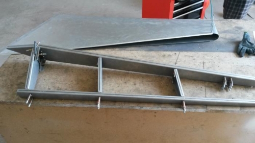

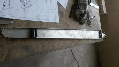

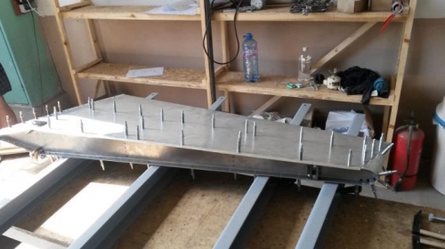

Brief Description:  Rudder pre-assembly
1. Allocating all components and inspection for damages performed according
M320 IPC, PARTS LIST 355M5 Rudder Assembly performed.
2. Following the DWG 355M5 and instruction for assembly internal and external structural components joined and drilled through the pilot holes for initial pre- assembly of the Rudder
3. Final geometry check of rudder assembly performed.
4. All holes in the structural parts drilled to final diameter and deburred as per the drawing 355M5
