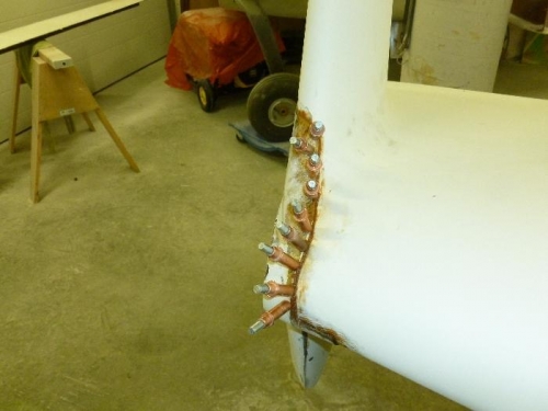

Brief Description:  Used heat gun to round front winglet bottom
Tonight I pulled all the clecos from yesterdays work and got things ready for the front to be heated and pulled into place. I used a file to get the surfaces ready and then trimmed some bit off were it was not needed, then on went the resin and flox mixture. I then mixed up resin and flox and applied to both sides and started to heat up the fiber glass and work my way from the bottom to the top drilling and clecoing the front into place. It worked very well and should be set in a few days to be sanded and then filled in.
Pilot side heated and clekoed
Co-Pilot side heated as well
