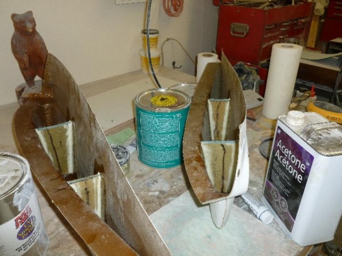

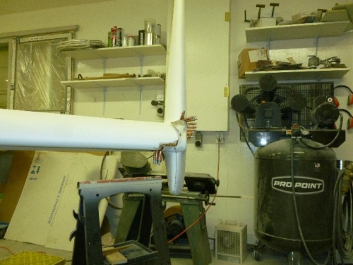

Brief Description:  Ribs installed and winglet bottoms floxed on to wi
I got the ribs cut and dry fitted and then it was time to install them. As usual bondo was used to hold in place the ribs for the micro to be installed and then one bid to tie it all together. I used Alpha poxy for all of this. The winglet bottoms were then set in place and clecos used to align the bottoms before floxed into place. I mixed up structural resin and flox and then smeared on the parts and clecoed into place. I will work on the front some more once set and then add filler to blend in.
Ribs installed
Ribs installed
Pilot side bottom in place
Co-Pilot side done as well
