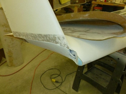

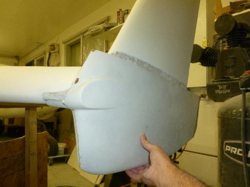

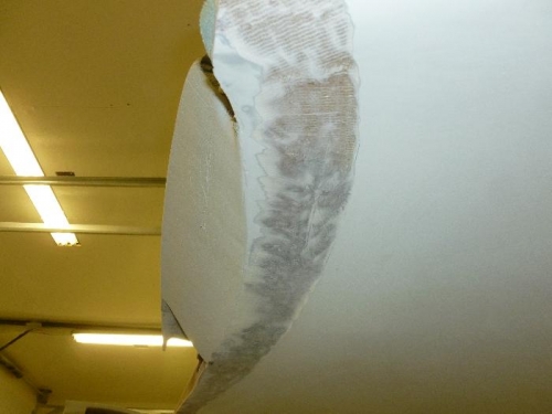

I stared by blocking out the winglet bottoms to have them straight for attaching. I marked where they are to go and then added ¾ for the one bid to go into place once milled fiber is used to glue on. I see there will be some special work to have this attached with smooth transitions. I will be adding ribs on the inside as well.
Filler ground off

Getting ready for attachment

This is what it should be
