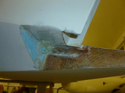

Brief Description:  Time to install the rudder horn.

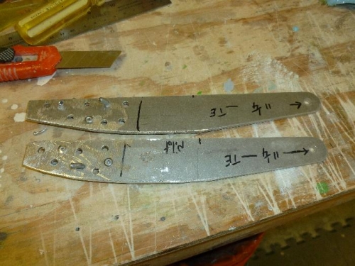

I started to fit the rudder horns for clearance and the right length, some material had to be sanded and removed. The swing should work well were I had marked the rudder. The rudder was drilled out were the horn is to go in. The horn was prepped with removal of aluminum to fit and holes drilled for micro to bit into, I also added 3 rivets to have something for the micro to hold onto.

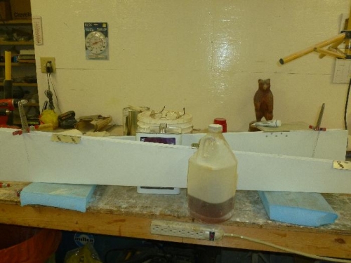

I will glass in the pocket after any adjusting is needed.
Prep for rudder horn
