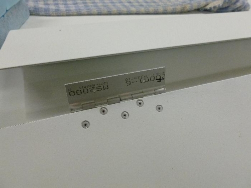

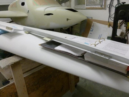

Brief Description:  Mounted the rudders hinges to the rudder with T88
Well I got some time in on the plane. It was busy day with painting and a plane ride 50 minutes a way to Penticton to see a B17 bomber from Arizona. Then back home BBQ and down to the shop to get the hinges glued and riveted on the rudders. I got things sanded up and ready to be glued on. The hinge pins were shortened and the ends of the hinges got a center punch hit to close up the end a small amount to prevent the pin from falling out. The T88 and flox got me all sticky by applying to much and it squeezed out all over this brought the hart rate up and I had to get away for a shot walk to clear the head. The holes had to be chased for rives to go in and that too was stick stuff.
Any way I am moving forward.
Counter sunk rivets
Counter sunk rivets
Hinges are on
Hinges are on
