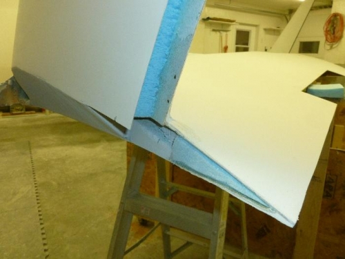

Brief Description: Sanded rudder wells and added were needed
I had to sand one more rudder so I got that done and moved onto adding some glass to the rudders were they were cut to short. Easy stuff to fix and bondo will hold in place while the 3 bid lay-ups cure on the inside rudder wells. I have filling and sanding to do on the rudders when the glass work is done. Things just take time.
