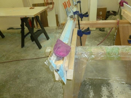

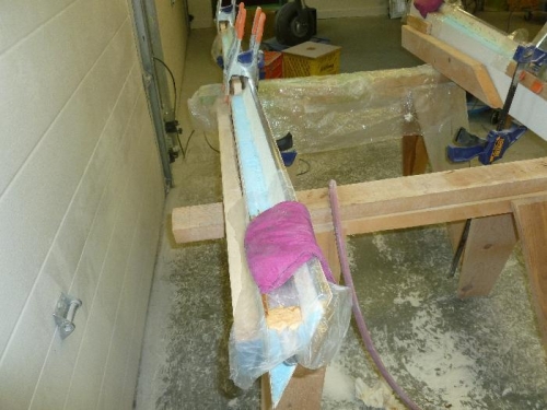

Brief Description:  Resin in torque tube and backing plate
After lunch I sanded everything and drilled holes in the short flange part of the hinge plate for the milled fiber to bite into and stay.
Holes were also drilled or punched into the foam to add more bit and hold.
Now it was time to mix up stuff and put it all together. Construction resin and milled fiber for the aluminum to glass and construction resin with micro balloons for the aluminum to foam. I added some pressure to squeeze out the extra resin and to hold in place until the resin is cured.
Torque tube in backing plate on
All the hinge plates are in
