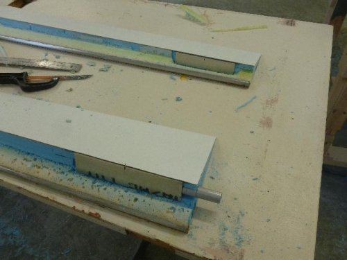

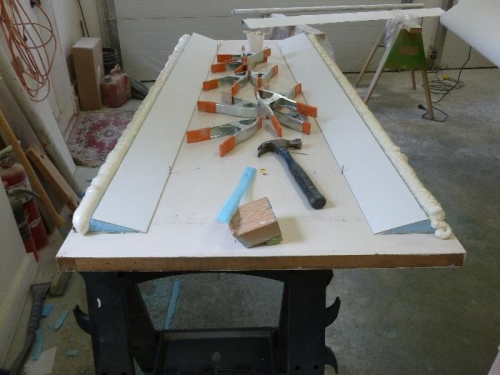

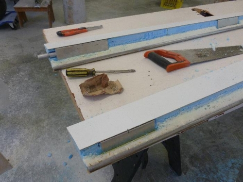

Brief Description:  Prep and install torque tube and hinge backing pla
I started by cutting the expanding foam and then sanded to shape. I cut the backing hinge plates and worked on dry fitting them into place. I had to trim the aluminum on the outward aileron backing plate to fit right the others were ok. I then set up some sandpaper on the extra torque tubing and sanded out the well for the torque tube to go into. The hack saw remove lots of foam before sanding it. It's now ready for the resin work.

Added foam was cut
Added foam was cut
Dry fit and ready for installation
Torque tube ready to go in
