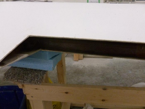

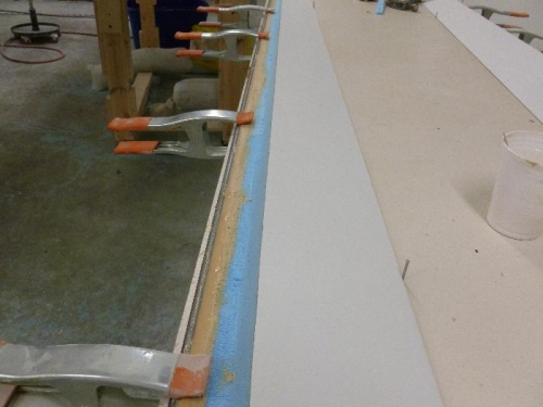

Brief Description:  Aileron construction & counterweights
I sanded up the glass that was cut long on the aileron wells and will sand the bottom when I go to mount the ailerons. There always seems to be a good side and a not so good side were thing did not go perfect and will require a bit more work.
I will get some expanding foam from the hardware store and fill in the areas that need it.
I mixed up some construction resin and added flox and micro balloons to the glass that the counterweight goes onto. I then added micro to the side of the weight and foam to hold the rod in place as well.
Well glass sanded
Well glass sanded
