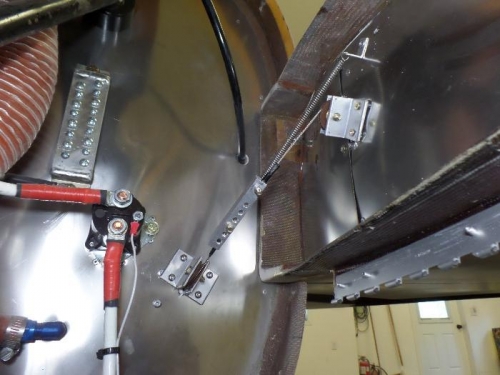

Number of Hours:  8.00
Manual Reference:  10.2.1
Brief Description:  Heat protection done. Cable wheels in place.
I cut the stainless steel for the wing face and riveted on. Next was the cable wheels and that was a big job. Nut plates were used on the wing and screws on the fire wall. I used tooth picks to hold the cable in place to get a location for mounting. I wish I had a big shop to build the plane this would have been done before the engine was mounted.
Heat protection riveted on.

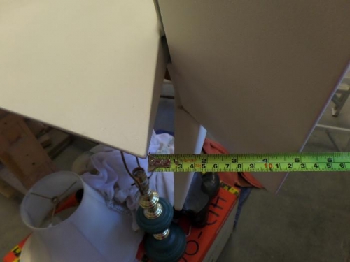

Good rudder deflection.
All set up and working.
