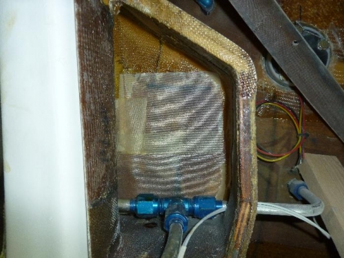

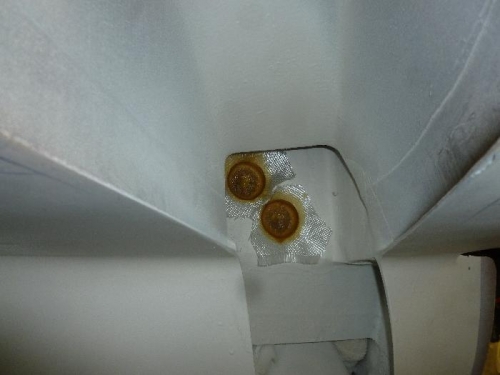

Brief Description: Welding plugs for external charging and jumping.
I used a hole cuter to remove the outer glass and microed the area and then added glass to the out side and inside. I will trim when ready. The shop is a little cooler these days as the temperature in below 20 Celsius.
