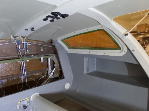

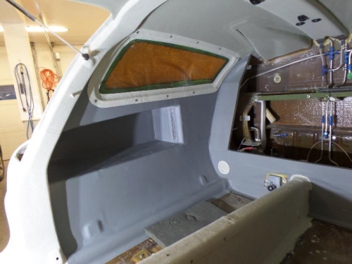

Brief Description:  Painted window trim and touch up in the fuselage.
It was time to clean up the mess from contact cement over run with a spot of Zolatone paint that I used on the fuselage. I also added some vinyl and paint to get ready for carpet. Once the carpet is in I will line with cardboard to keep clean. I needed to counter sink the window trim for the washers to fit flush. Odd and ends day.
Also the cabin vents were installed to remove air and to allow fresh air in. There must be air movement or the heater and clod air supplies will not work.
Window trim is on. Vent too.
4 coats of Zolatone on window trim
