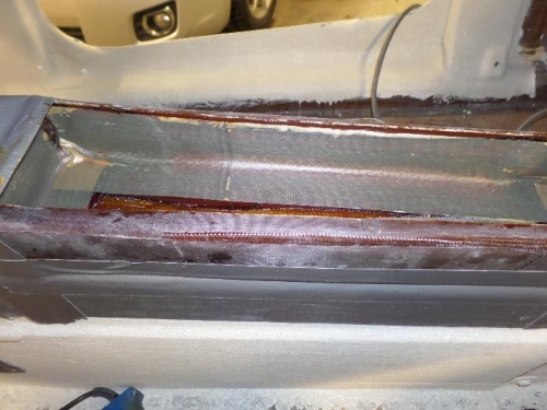

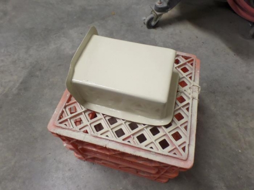

Trim motor box was filled sanded and primed and is now ready for the interior paint to go on.

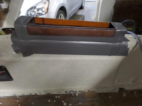

The armrest was trimmed and fitted for the plane with duct tape underneath for the mounting flange to go in. I did a 3 bid lay-up on this flange because the rest will be bumped at times and it needs to be held in there well. I mixed up micro for the corners and did the fiber glass work over top of the micro.
The armrest will have USB plungs in the front and back with a tilt up top for small things.
Trim box has primer on it.
Armrest in position for flange.
Fiber glass work done inside.
