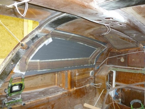

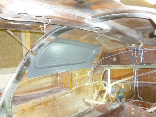

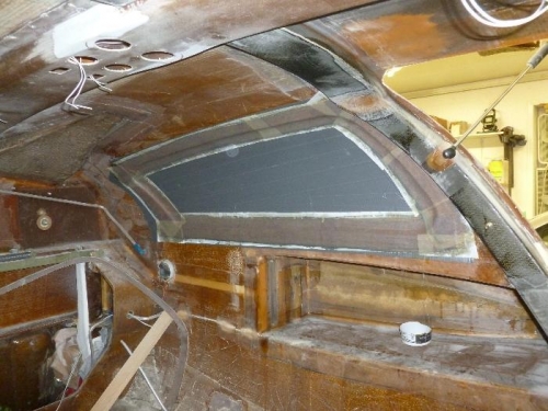

Brief Description:  Made window frames with 4 bids of fiber glass
Well I gave up trying to fit the frames that came with the plane. They were so far off that a magician would have their job cut out for them. I cut bid today from the end of my roll and it was just enough to do the job. The window was taped up and marked for the bid to go on. 4 bids were applied to the window to make a frame. I did in 2 lifts with 2 bids per lift. Cynthia asked if I was closing in the window and I said that I was making frames for the windows and upholstery would go onto the window frames. Cynthia also said that she could not believe that I was building a plane. I will that that as a positive note.
Ready for glass
Ready for glass
4 bids and peel-ply
4 bids and peel-ply
They fit the plane.
They fit the plane.
