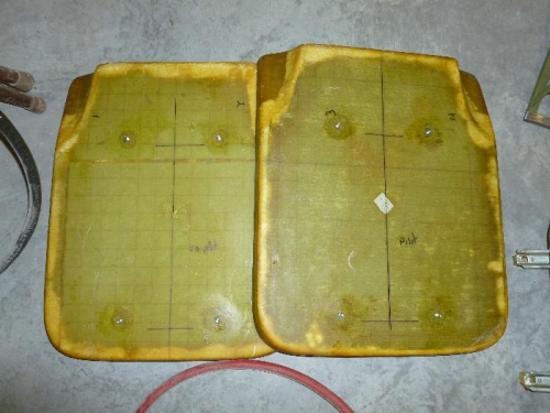

Here the bolts are fibered in place and filed with flox and balloons to the top with one bid to finish off.
Bolts being fibered in place.
Ready for filling.
Bolts are set in place.
