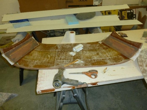

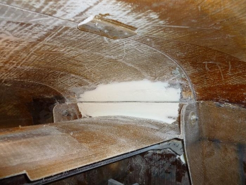

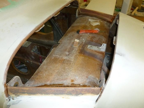

Brief Description:  Sand level dog house area for hinges then cut free
I finally got the dog house area sanded with only one nickel bleeding. I used gloves after that and then cut the dog house free with the hack saw just pulling it on the cut line one hit and off it came. Things were sanded and radiuses for the bid to go on. Micro first and then wet up the area and on went the fibber glass cloth and the heat gun made it all flow out nice, peel-ply too.
I need to find a 90 degree drilling tool for the restricted area to work in for the rivets to go in at right angels to hinges. I will see what there is in town or with a friend.
There is no resistance now on the hinge pins.
Sanded and cut free
Sanded and cut free
2 bid on micro for strength
2 bid on dog house as well
