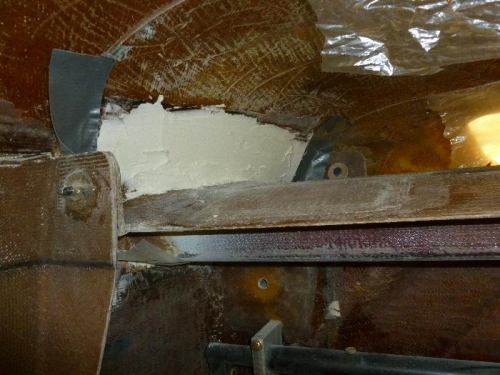

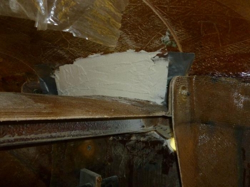

Brief Description:  Sand and apply one more coat of micro
Wow this is a very hard place to get into for sanding. I tried the hinge again by pressing up in place and the pin was hard to move still and a straight edge showed 3/16 low in the middle and this is enough to cause binding. Once all is good I will add 2 bids to the micro and mount the hinges and come up with a locking system to keep the pin from coming out. This is taking longer then I thought to finish the canard mounting and finishing, Oh well that’s how it goes some times.
I also put the resin hardener into a bucket and added boiling water 4” from the top to dissolve the solids. I will use up every thing I have before ordering more stuff. I do think I will have enough to finish the plane only time will tell on this.
More micro on to level out
only had to add 3/16 to center
