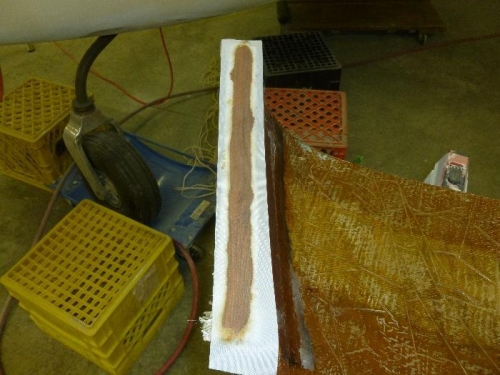

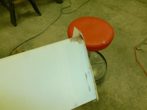

The elevators were not perfectly matched from one side to the other as to the distance from the fuselage so I added some foam and bided the 3 sides and it should look better now.

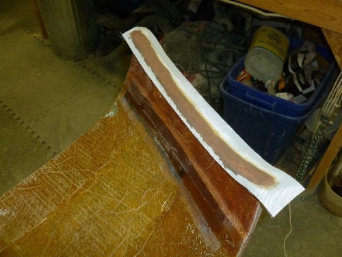

I am very happy with the way the dog house turned out. I will only have to add 1/16 filler to the bottom corners to blend with the fuselage. I added one bid to the bottom and will let set over night and trim tomorrow.
The dog house will be mounted using hinges with a removable rod this way no screws will be seen.
I will have to add a small amount of filler along the dog house to fuselage in places so the gap is 1/16 on both sides for primer and paint. I will also add at the center of the fuselage so the dog house does not sag.
Elevator end has been added too
One bid on dog house bottom
