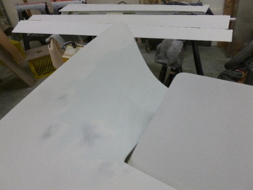

Brief Description:  Level elevators and drill weight holes. Set up pla
I finished sanding the canard tip and moved onto the elevators. The JB weld had set and now it was time to level everything and drill the new holes at the weights. Everything went very well and the elevators are nice and level with each other.

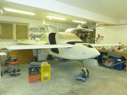

The plane had to be rearranged for the canard to go on and then finish the control tube from the stick to the elevators.
I will be cutting a wedge to a round hole for the torque tubes and finish this up as a bolt on item. Some use an O ring to keep water out at this area but I will use thin stick on weather stripping foam. Once the canard is in and sitting at the right spot then the control tube will be done.

Canard in place and control next
Long time since canard was in place
