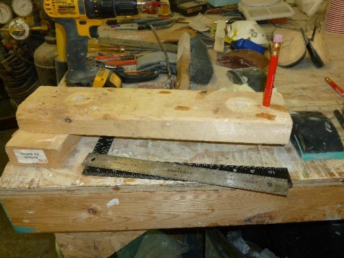

Tonight I marked the canard trailing edge and cut to width and cleaned up from the other biding day on the ends. The tool to mark the 11-7/8” was very helpful in getting the right width all the way down the canard. Once marked the cutting and sanding was next.

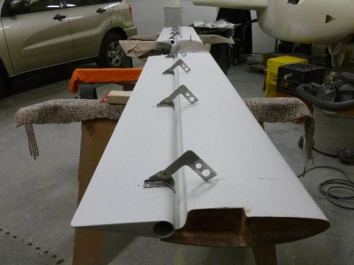

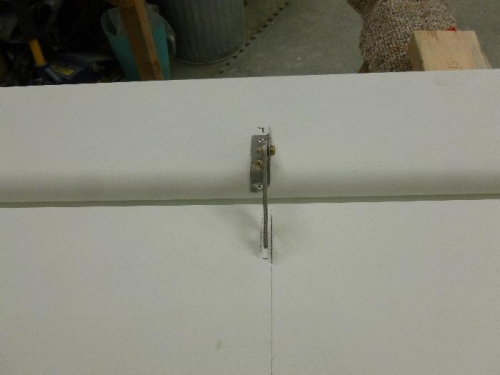

I bolted up the hinge arms and got into position for were they are to go. Next will be to cut the skin and remove foam and glue into place.
Tool for marking trailing edge
Arms are bolted up
Arms are bolted up
Roughed in and ready to cut slots
