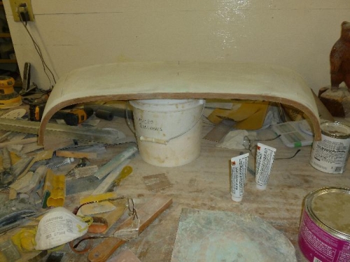

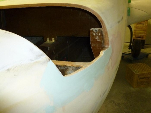

I trimmed the bid on the dog house tonight and sanded the edges up. The fuselage was also sanded on the dog house face.
Peel-ply came off the Instrument panel flanges to fuselage. Lay-ups were perfecto, the heat gun is a must to flow out bubbles.
Dog house bid trimmed and sanded
Fuselage bid sanded.
