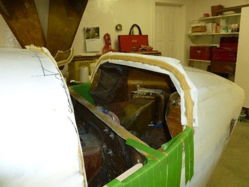

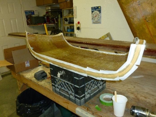

Brief Description:  1 bid on dog house and fuselage face's
I had 45 degreed the faces earlier and how it was time to fill in with slurry and one bid on top with peel-ply to finish the dog house face and the face on the fuselage. The area with the green tape is peel-ply on the bottom and plastic over all of it. The plastic worked great over top of the resin and bid to pull every thing down and keep out air bubbles.
Dog house with bid & peel-ply
Fuselage with peel-ply
Green tape over plastic to keep out air bubbles.
