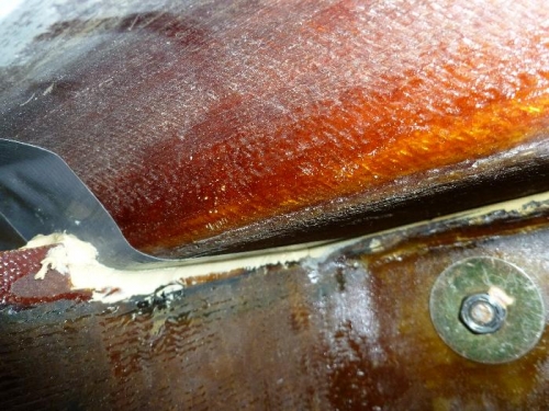

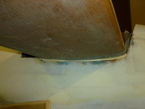

Fill the under side gap.
I mixed up micro-balloons and resin for the gap to be filled between the fuselage and bottom of the canard. I push in place on the fuselage foam gaps and built up ½” and installed the canard to make a bed for the sides.
Pilot side filled in
Co- pilot side filled in
The inside back pilot side
