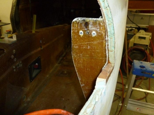

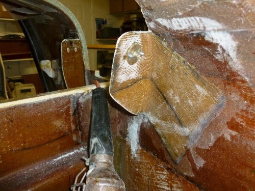

Cut and prep tabs for nut plates and then install
I trimmed the tabs and got ready for nut plates to be fitted and riveted in place. I used T88 structural resin will milled fiber to glue in place. The rivets were counter sunk.
Cut tabs and install nutplats
Structural fiber glued nut plates in place.
