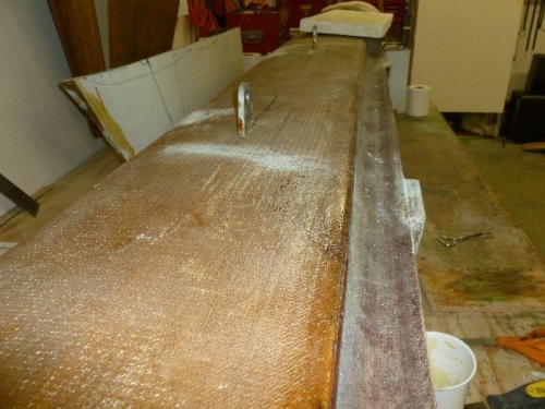

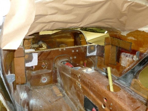

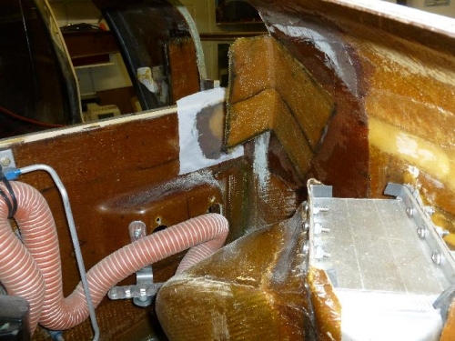

Brief Description:  Cut backing boards off and remove Canard for clean
This was fun cutting the bondo. I used Cynthia’s hair mirror and thought I was a dentist to see the bondo in behind that had to be cut to remove the backing boards. I then removed the bolts and used a putty knife to pry just enough to break free the Canard and out it came with no problem. I had to remove the bondo from the bottom of the Canard so the tools used were a sharp putty knife as a chisel and a medium file.
Back tabs need clean up now
Front tab
Front tab
Canard bondo removed
