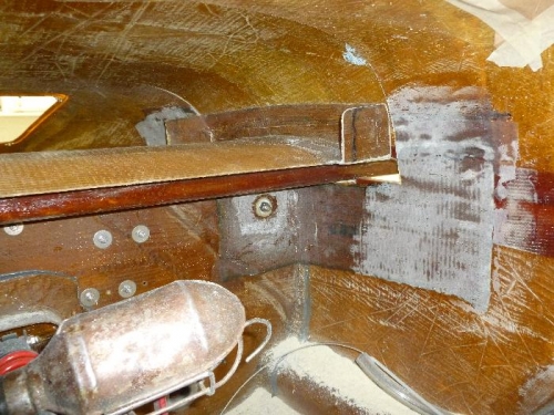

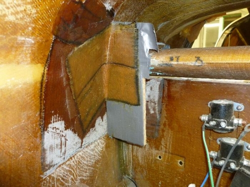

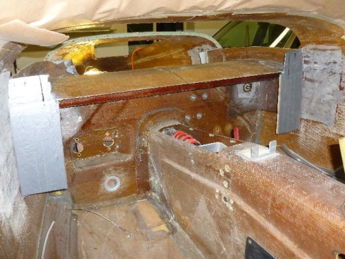

Brief Description: Make front and back fusalage Canard tabs
I put the Canard back in after sanding the areas for the TRIAX lay-ups for the tabs which hold the front and back in place. I first cut wood and duck taped up for the TRIAX to go up agents’, bondo in place and mark 3”for the tab size. Lots of resin for this job but it needs to be strong that Canard has a big job to do out there in front. I once again used Cabo-sil to thicken the resin. It seems to speed up the quire time and that’s good for moving on to other jobs. Peel - ply and it's 11:30 pm, the day worked out good. Got lots done on the house jobs too.
