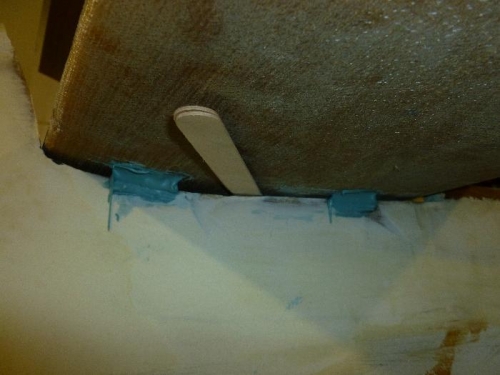

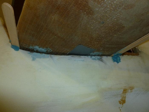

I spent a few hours getting the canard level and true in all direction. I checked it one more time and had to lift the pilot side to have it level with the back spar. Once I was finally happy I used bondo and tong depressors to hold at the right spot when removed to drill the holes in the bulk head for the attachment points.
