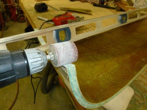

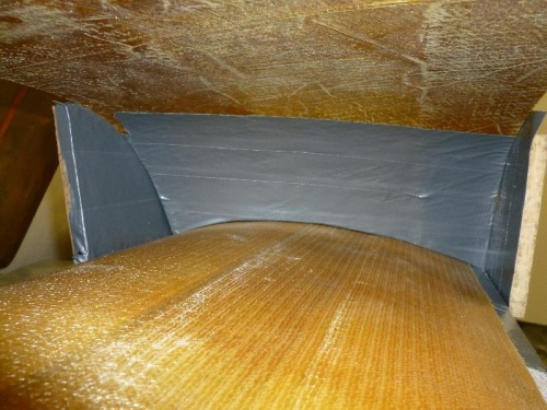

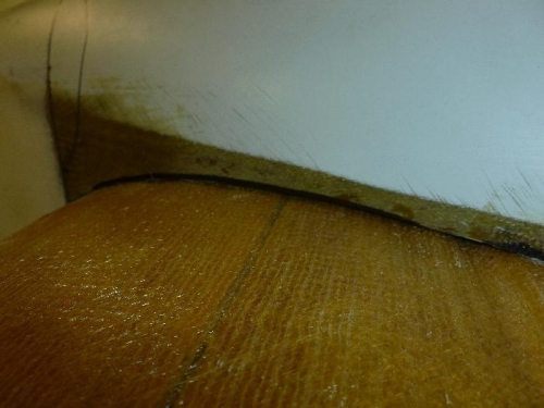

I put the dog house in place and marked with a black felt pen where the dog house needed sanding to fit. After sanding and using the level to simulate the Canard it was ready for placement. The sanding drum worked very well for this job and it took no time in getting the Canard ready for placement. I taped the dog house before I bonded it in place on the Canard this way the face of the dog house will not resin it’s self to the Canard.
Felt penned the areas need to be sanded
Drum sander work great for this
Dog house is ready for TRIAX
