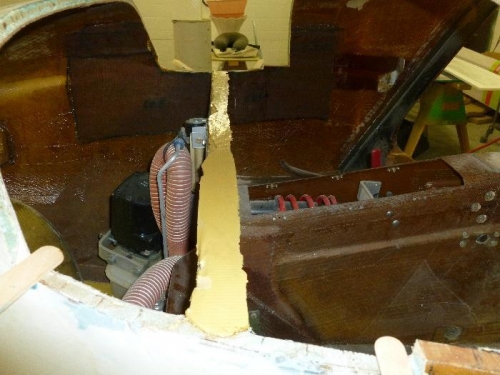

Brief Description:  Structurally resin in the hard point to the bulk h
I mixed up some resin and Micro balloons for the Canard bed of the bulk head to seal out the weather and for a bed to sit on. I them mixed up T88 Structural adhesive with milled fiber and wet the bulk head and then the knurled hard point and slid in on the bolt and tighten up with only a nut. Vaseline was used on all part that was not to be glued.
Structurally installed hard point
Micro balloons bed for Canard
