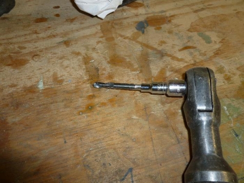

Brief Description:  Drill holes in bulk head for attachment points.

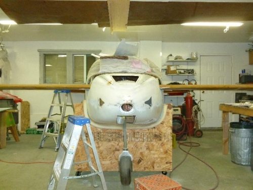

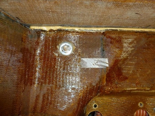

After using the air ratchet to drill the holes in the bulk head I had to dry fit everything and this took sanding out the holes so that the knurled hard attachment point would just slid in on the bolt with about 1/6” for the glue to go around the outside. The Canard attachment point was not square to the bulk head so when I glued the point in it was at an angle. The two touching faces had Vaseline on them to not allow the structural glue to set on them. When I tightened up the nut it only pulled the two attachment point together floating in the structural glue. This way there was no changing the attitude of the Canard.
Had to make up a drill tool
Hard point in place
Hard point in place
All is level
All is level
