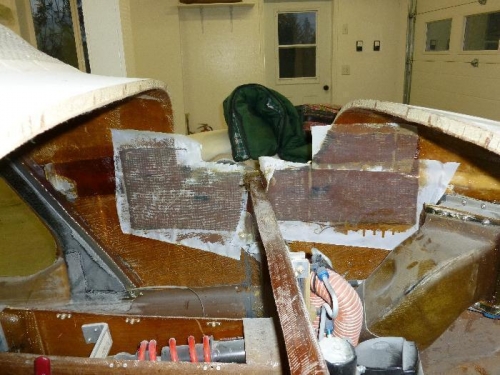

Before the Peel-Ply was done I added 2.5” of TRIAX to the top of the lay-ups to have the reinforcement go up the fuselage further. I did a 2 bid lay-up to connect them together.
I will have to make a cradle now for the plane to sit in and reposition it in the shop for the Canard to go on.
Co-Pilot side done
Co-Pilot side done
Pilot side done
Pilot side done

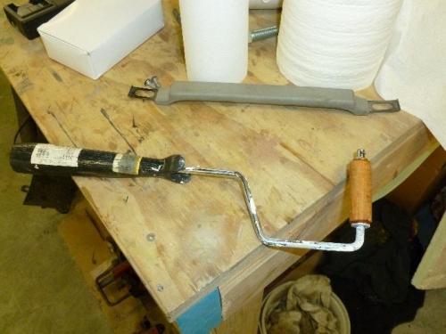

Wooden roller
Wooden roller
