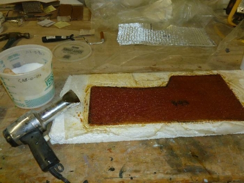

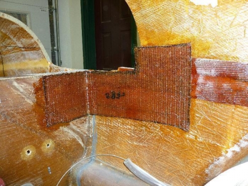

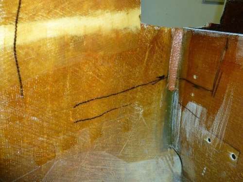

Before holidays in March I had cut the TRIAX to be installed but never got to it until today 7 months later. Wow what a busy summer it was. I marked out the locations and pre wetted the spots for the TRIAX. I used Flox and resin for the corners to have the TRIAX fit in nicely. The resin was thickened with Cab-o-sil and the heat gun flowed it out nicely. This works extremely well on TRIAX lay-ups and over head jobs. I used a roller to move out any bubbles in the lay-up. It was made from a piece of wood dowel and put on a roller handle.
TRIAX in place CO-Pilot back side
I Floxed in all the corners
Wetted out and ready to install
