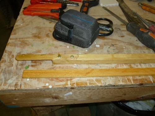

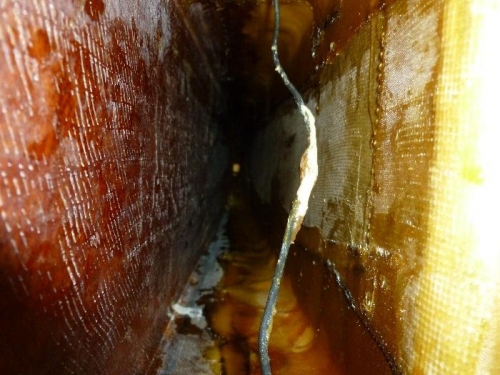

Brief Description: Hell hole done on Co-pilot side
I sanded as much as I could get at and wiped down with the smelling salts (acetone) I mixed up micro and radiuses the top stake to main spar followed by 2- 4” bid. This went better as practice from the other side paid off. I then got the bottom ready for bid just like the top. The stick had bid wrapped around it as it went into place and the tong depressor stick unpeeled it to lie out on the bottom to finish the bid lay-up. It was the most challenging lay-up yet!! >-<
