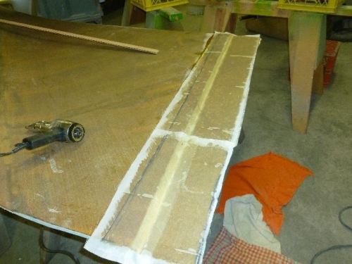

2 bid on back of strake
Here I cut with my dermal tool the top layer of glass at a 45 degree and then removed the foam to get ready for the lay-up. I used my air grinder to remove all the foam and get down to the glass.
2 bid on back end of strake
