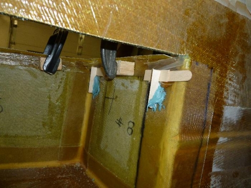

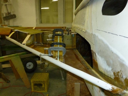

The flange on the right is being attached tonight. Got site ready with sanding and cleaning mixed up some Flox and applied on the flange and bulkhead.
Wedge sticks bonded in place is a trick I used in the Sawmills welding to push a steel plate down, up, or in. You cut a section out at one end and attach then use a wedge and drive in between the attached plate and the one that needs to go in to position in this case.
It work great pushing the bottom flange in.
