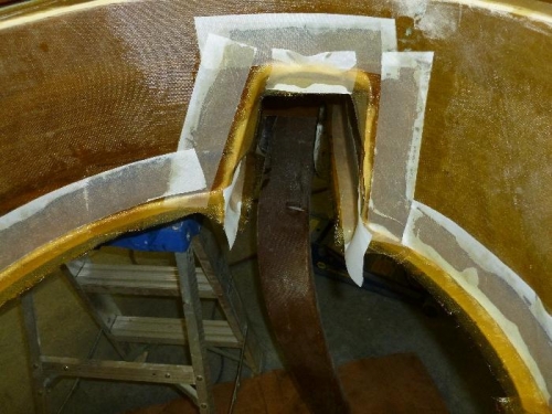

Brief Description:  Installed the wheel well tonight
Yesterday I fit and bondo the wheel well in place and got things ready to be bid in. I got going and missed fire practice tonight. The job took longer then I had anticipated. This is a major stepping stone to be this far along. Just the baffles off the wheel well to be put in on this strake and a few lose ends and I can start on the other side. I’m sure that will be 15 hours away or more.
The tight space behind the wheel well to the back bulkhead had me worried so I used short lengths of bid (6”) and over lapped them as I work around the back side. I was happy that it worked out so well with equal amount of bid on both sides of the gape. There is not a lot of room to be working back there but some how my hands got in there and guided the plastic with the fiber glass cloth on it into place.
Wheel well in place
Wheel well in place

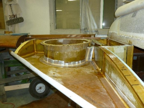

Lower stake skin attached
