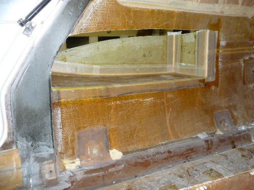

Bid in the other side of fuel bulkhead
I floxed on the 1.5"x1.5" angle to the side of the fuselage for the top to sit on with flox to glue it in place when the day is here. I then bid in the baggage side of the fuel bulkhead.
