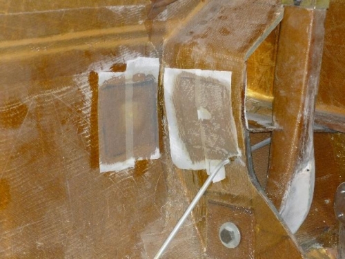

Brief Description: Bulkhead hard piont for fitting
It was time to install the hard point for the fuel out let so I drilled from the fuel tank side and cut out for the aluminum hard point to be floxed in place. I will be installing a second out let at the back of the fuel tank and tee them together. I see a few builders don’t do this but I will just to get every drop out of the tank if needed. I never fly with less then 1hour of fuel in my plane and after 2+ hours it's time to come down for a bathroom brake and a snack. I cut a ¾ hole through the gear bulkhead for the fuel nut to go through to connect to the tee. I used triax one side and 2 bids on the other for strength. Tomorrow I will bid in the tube to the back of the tank
