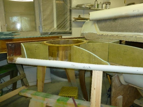

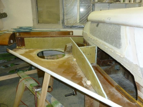

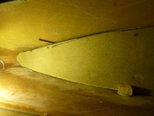

Got lots done today fitting the bulkheads and baffles into place with a 3/16” clearance for the flox glassing when the top goes on. The top was on and off lots of times to get the right fit. Measure cut and sand all the pieces.
Drill bit for clearance
E (5) bulkhead in place
Taking shape!!!!
