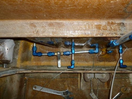

Sump tank go back in

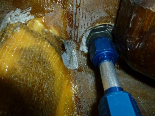

The TRIAX on the bottom Co-pilot side had to be hogged out to have the true nut recessed into the TRIAX to have enough threads to tighten properly. The sump tank was in a out a few times here to get it all to work right.
Steel true fitting nut had to be recessed.
Every thing back in one more time.
