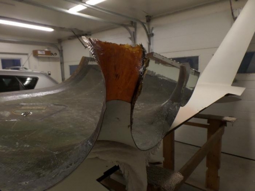

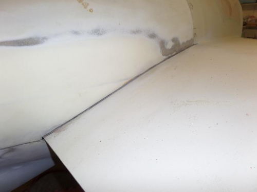

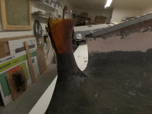

Brief Description:  Worked on cowling. Prime, sand and fill 4 bids on
It has been very busy around the house so I only got a few hours here and there on the plane. The cowling was primed and filled and sanded then primed again. The next thing to do was to add a 4 bid lay-up to hold the back cowling into place at the cooling outlets to align. The cowling was torqued so heat was applied with lights before I removed the clamp that was holding the top and bottom in alignment for the bid to cure. I trimmed and sanded the out let. Micro and primer to finish this area is the next thing to do to finish this part. Next will be the rudder cables.
Sanded and ready for primer.

Cowling cooling opening connection.
4 bids on this item.
